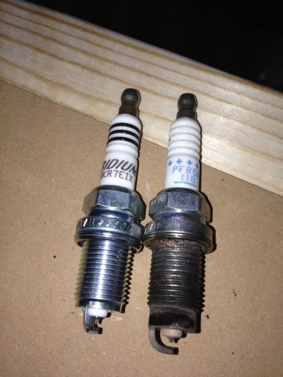

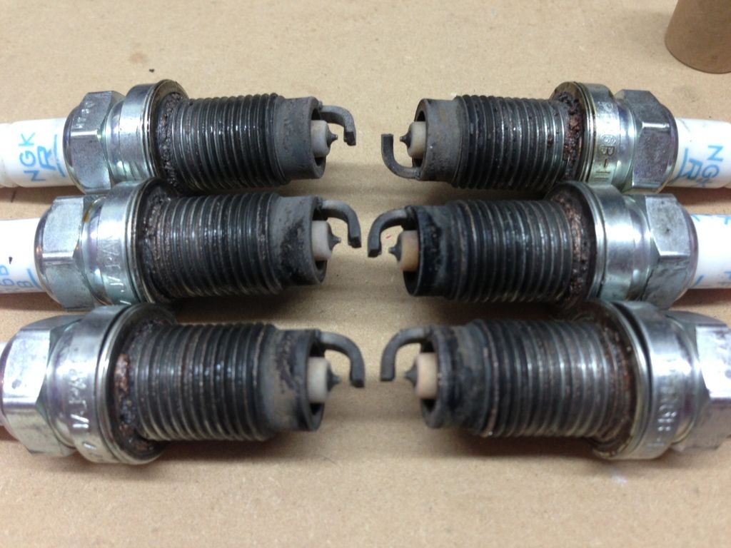

Message Turns out it was my spark plugs. They were the pfr6b-11b's with only 2 maybe 3 thousand miles on them. They did have quite a few 21psi+ runs at the drag strip on them in 100 degree weather though. Perhaps that played a role.
Anyways, I decided to switch to BKR7EIX and now the Z feels just like it did the day I had it tuned at SpecialtyZ.
I don't know for sure yet but I think they were also the cause of my poor gas mileage. I've been averaging 11-12 mpg and that's with staying out of boost due to the hesitation. At idle my afr was always bouncing around the 10:1-12:1 range. With the new spark plugs it quickly finds that sweet spot at 14.7:1 again. Hoping for better gas mileage now!
